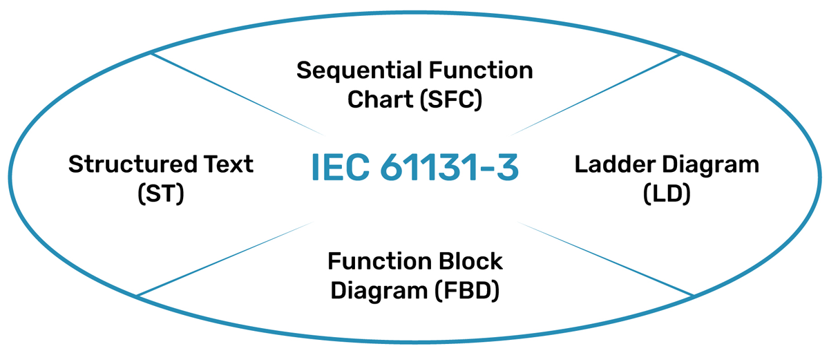

IEC 61131-3 is an open standard for PLC control programming languages.

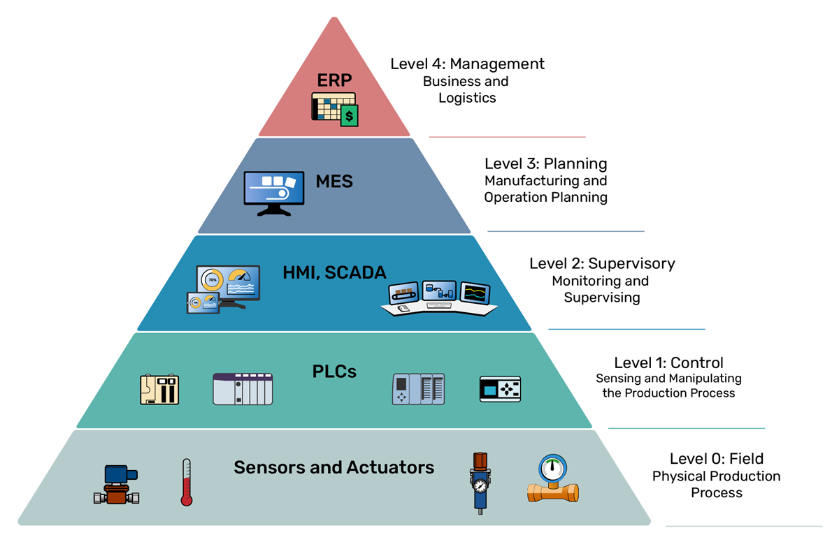

Defining (and Redefining) the Stack
The traditional automation stack (shown below) developed over decades. It reflects how systems were built when network bandwidth was limited, integration tools were scarce, and each layer addressed a specific problem.
At the lowest level, sensors and actuators connect to the process. As you go up the layers, PLCs read inputs and execute control logic. HMI and SCADA systems display data and provide operators with control interfaces. Historians store data over the long term. Higher-level systems—like MES (manufacturing execution systems), ERP (enterprise resource planning), and OEE (overall equipment effectiveness) platforms—consume historian data for reporting and business use. Data moves upward, one layer at a time.
If you need a temperature reading at the enterprise level, it typically passes through the PLC, then SCADA, then a historian before reaching any reporting or analytics system.
That model made sense when systems were isolated and integrations were limited. Each layer did its job, and data moved through fixed paths. But this structure creates friction over time. Each layer can reshape data, require its own protocol drivers, add licensing costs, and create dependencies on the layer below it. The stack becomes rigid. Changing one layer risks affecting others. Scaling to another site often means rebuilding the same vertical structure.

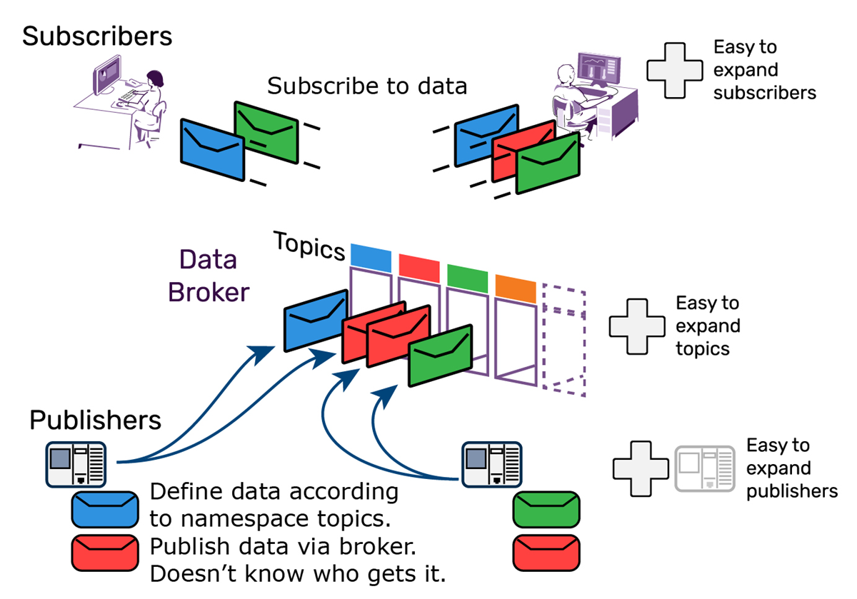

Modern Messaging Changes the Layers
Publish-subscribe protocols like MQTT remove the requirement for data to move strictly upward through fixed layers. Instead of pushing data step by step, a controller or edge device publishes data once to a broker. Other systems subscribe directly to what they need.
The model shifts from vertical to shared:
  • Traditional: Sensors → PLC → SCADA → Historian → Enterprise
  • Decoupled: Sensors → PLC / Edge → Messaging backbone (broker) → Multiple subscribers (SCADA/Historian/Enterprise)
With a publish-subscribe protocol like MQTT, a controller or edge device publishes data once to a broker. Other systems subscribe directly to the data they need.
Control stays where it is. What changes is how data moves after it leaves the controller. Data no longer climbs the stack one layer at a time. It becomes shared infrastructure that multiple systems can access independently.
That shift makes it possible to modernize or replace individual layers without rebuilding the entire system. You can keep your PLC and control logic in place but replace a proprietary historian with an open-source database. You can build a separate dashboard that reads from the same data stream instead of modifying your production SCADA project. You can connect analytics directly to published data without inserting another middleware layer. Because systems subscribe to shared data instead of depending on each other, you can change one layer without forcing changes in the others.

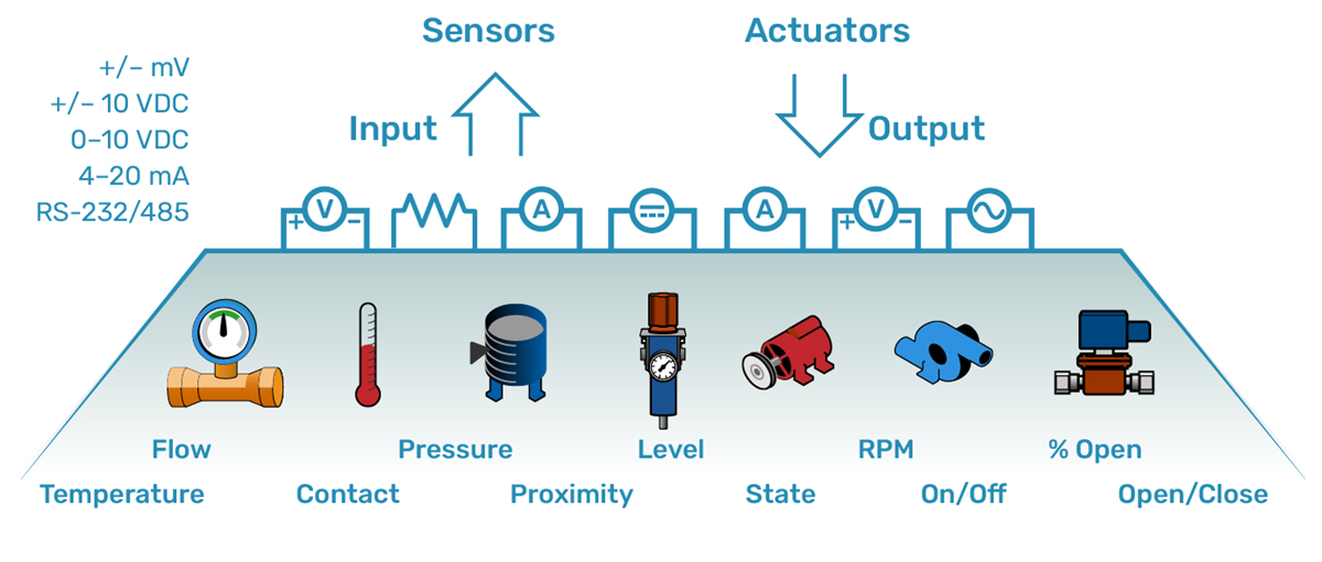

Sensors and Field Devices
At the bottom of the stack are physical signals. Most industrial processes rely on standard electrical interfaces: 4–20 mA, 0–10 VDC, thermocouples, RTDs, thermistors, discrete I/O, and dry contacts. Actuators are typically driven through discrete outputs, analog outputs, relays, and standard motor control interfaces.
 Open architecture often starts at the bottom of the stack, with standard electrical interfaces.
These signals are not proprietary. They can be read or driven by any PLC or capable edge device. While controller ecosystems may be vendor-specific, the field layer is largely standardized. That gives you flexibility at the hardware boundary. Open architecture often starts here, using standard electrical interfaces that any compliant controller or edge device can support.

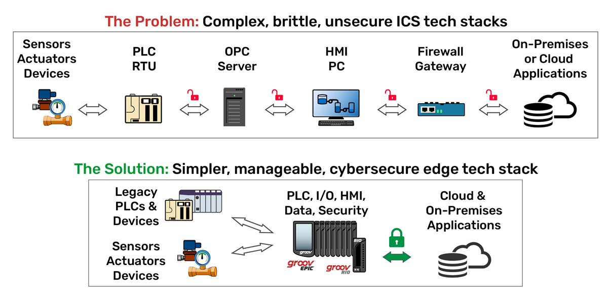

The Edge: Expanding the Role of Control
In the traditional stack, the PLC already lived at the edge. It connected to field devices and passed data upward. When additional integration was needed, plants added gateways, OPC servers, or vendor middleware.
What has changed is capability. Modern edge devices are not just protocol bridges. They can provide local processing and real-time control, secure network segmentation with firewalls and VPNs, built-in support for open protocols like MQTT Sparkplug®, OPC UA, and RESTful APIs, and services to model and contextualize data before publishing.
Modern edge devices can make a complex, unsecure industrial control system (ICS) simpler and more cybersecure.
In some architectures, this capability sits alongside the PLC. In others, modern edge programmable industrial controllers (EPICs) allow the controller itself to perform all of these roles. A modern edge controller can execute IEC 61131-3 control logic while also running tools like Node-RED or Linux services, and publishing data using MQTT, OPC UA, and REST. The PLC functionality becomes one responsibility of the edge device, not its only purpose.

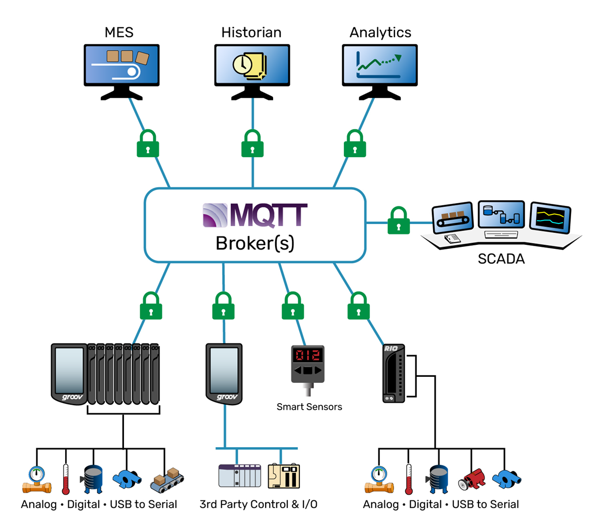

Data Movement: Building a Shared Data Backbone
Once data leaves the controller or edge device, the question becomes how it moves. In the traditional stack, data moves upward through tightly coupled, individually configured poll/response connections. A PLC feeds SCADA. SCADA feeds a historian. The historian feeds higher-level systems, like MES and ERP.
That approach works—many plants run today because of it—but working is not the same as optimal. The traditional model served its era well. Today, the tools exist to do better, and the cost of not adopting them compounds over time as integration demands increase.
Adopting a new architecture often follows a J-curve. There is initial friction as teams learn new tools and legacy habits must change. There may be a temporary dip in comfort or productivity. But once the new model is in place, the gains compound. Flexibility increases, costs stabilize, integration becomes easier. The challenge is not technical; it's the willingness to commit to the transition.
In a publish-subscribe model, a controller or edge device publishes data once to a broker. Any authorized system subscribes to what it needs. Open-source brokers commonly used in this layer include Eclipse Mosquitto® (lightweight, stable, widely deployed), EMQX® Open Source Edition (high performance with clustering support), and HiveMQ® Community Edition (popular commercial vendor with a free edition).
These brokers are free to download and run. They do not require per-tag licenses. They do not care which vendor produced the data. When structured correctly, this messaging backbone becomes what many call a Unified Namespace (UNS).

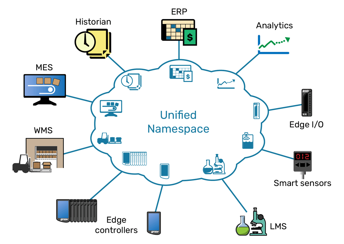

A Unified Namespace is key to collecting data from the edge and dispersing it to the systems that need it.
A UNS is not a product. It's an architectural pattern. All devices publish structured data to a central broker. Topic hierarchies represent equipment, lines, or sites. Any application subscribes to the data it needs, and no application depends directly on another application.
The result is decoupling. Storage does not depend on SCADA. Dashboards do not depend on historians. Analytics do not require new drivers. You publish once and subscribe anywhere.

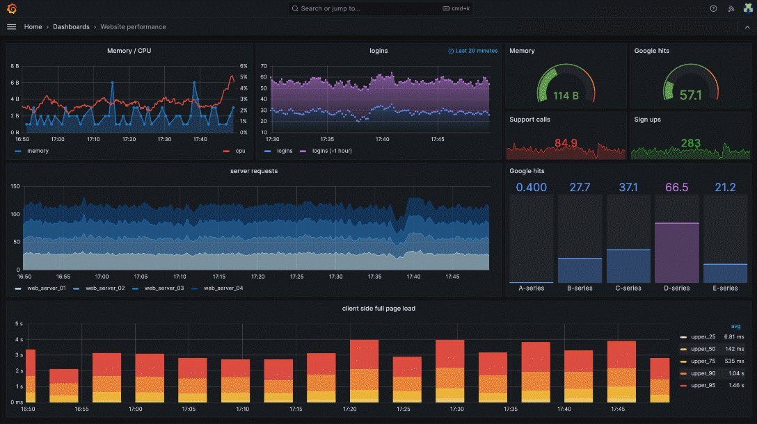

Visualization and Dashboards
Once your data lives in an open database or is available through a messaging backbone, visualization no longer needs to be confined to your SCADA system. Traditionally, dashboards and HMIs are built inside a licensed SCADA platform. Adding users, screens, or remote access often requires additional licensing and modifications inside a production environment.
An open architecture separates visualization from control. Grafana®, for example, connects directly to databases like PostgreSQL, TimescaleDB, or InfluxDB using standard connectors. No proprietary drivers. No per-tag licenses.
With an open architecture, visualization no longer needs to be built inside a SCADA system. Dashboards and HMIs subscribe to shared data.
The open HMI or dashboard changes how you deploy visibility. You can build dashboards without modifying your SCADA project; provide read-only access to operations, maintenance, or management; create site-level or enterprise-level views; and deploy new dashboards without touching control logic. SCADA continues to handle real-time operator control. Open dashboards handle trending, reporting, and analytics. Visualization becomes another subscriber to shared data.

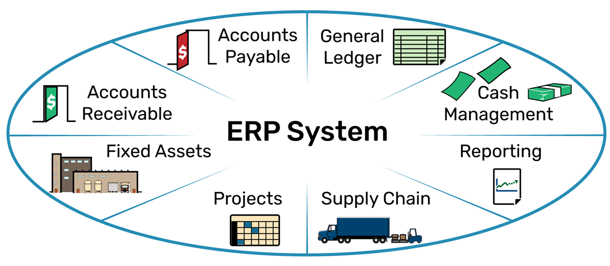

Applications and Business Systems
At the top of the stack are the systems that consume operational data: MES, ERP, OEE platforms, maintenance systems, reporting tools, and cloud storage. In the traditional model, these depend on SCADA exports, historian queries, or vendor-specific connectors. Each integration is custom and tightly coupled.
In an open architecture built on a shared data backbone, these systems become another subscriber. They can query an open database using standard SQL, subscribe to MQTT topics, or access data through REST APIs. No proprietary middleware. No per-tag drivers. You build the data infrastructure once, and applications connect as needed. Adding a new reporting tool does not require modifying SCADA. Connecting a new enterprise system does not require a new licensed gateway. The top of the stack becomes modular instead of custom-built.
In an open architecture built on a shared data backbone, ERP, MES, OEE, cloud storage, and other applications connect as needed.
Open architectures built around a shared data backbone make it easier to scale the system by adding edge publishers, data topics, and data subscribers.

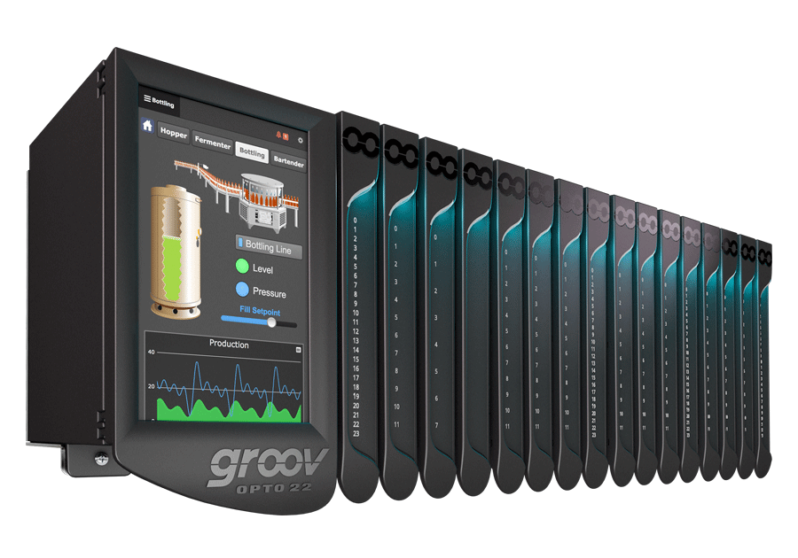

About Opto 22 Products
Opto 22 industrial automation products include the latest groov EPIC edge programmable industrial controllers and groov RIO edge I/O, as well as field-proven legacy products like SNAP PAC and solid state relays (SSRs).
With groov products, you can collect, process, view, and exchange data where it's produced—at the edge of the network—and securely share data among databases, cloud platforms, web services, PLC systems, and other systems and equipment. groov products give you built-in cybersecurity and multiple control programming options including CODESYS, plus Node-RED, Inductive Automation's Ignition Edge, and MQTT communications.
Opto 22 products are ideal for OEMs and machine designers, process control, machine monitoring, power and energy monitoring, predictive maintenance, remote installations like water-wastewater and oil & gas, SCADA, and industrial internet of things (IIoT) applications.
