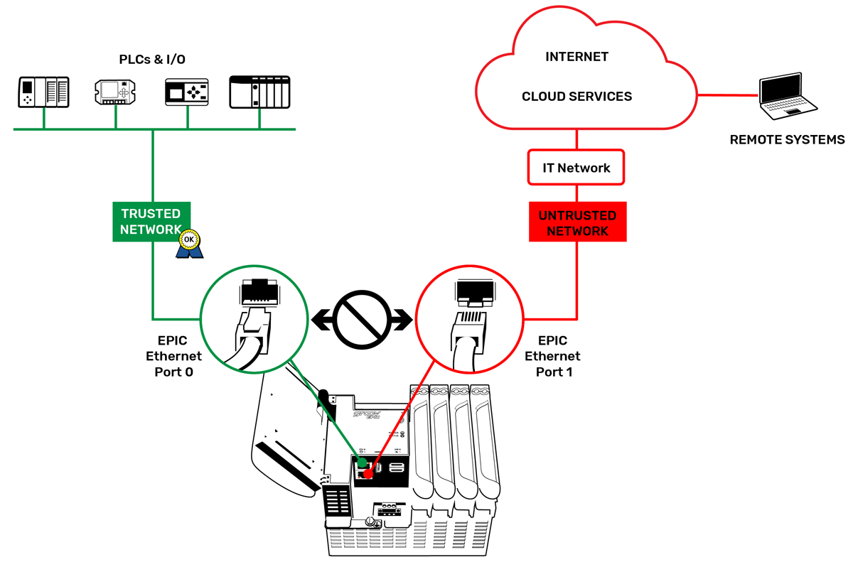

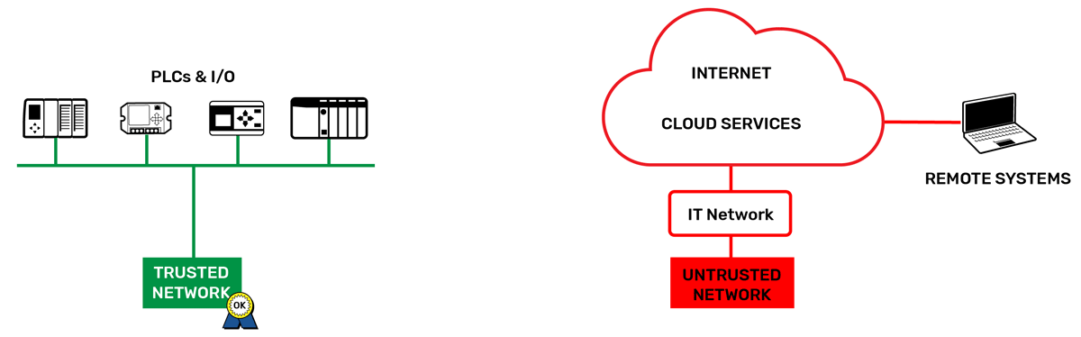

A key concept in the ISA/IEC 62443-3 specification on Industrial Cybersecurity is zoning—keeping networks isolated to avoid unauthorized access to data. groov products include options for multiple network interfaces, to isolate trusted networks from untrusted networks.
  • A trusted network is any network where you know exactly who has access to it, for example, your OT network where existing PLCs and I/O reside.
  • An untrusted network is any network where you don’t know who has access to it, like an IT network or the internet.
groov

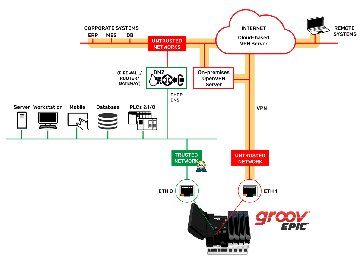

EPIC processors include two independent Gigabit Ethernet interfaces, each with its own IP address, that isolate trusted networks (on ETH0) from untrusted networks (on ETH1). EPIC is not a router, which functions to join two networks together. Instead, groov EPIC’s default configuration keeps your trusted networks and your untrusted networks apart, separating them into zones. This default configuration eliminates any chance of unsecure devices on one network interface being exposed to the others.
By default, groov RIO’s two built-in network interfaces are switched and use the same IP address. However, with firmware version 4.1.0 or higher, you can configure them to be independent, separating your trusted and untrusted networks into zones just as a groov EPIC does.
Both groov RIO and groov EPIC provide additional network interface options. For example, you can add a WiFi network (a WLAN) to groov RIO or groov EPIC using an approved USB WiFi adapter connected to the USB port. (For more information on approved adapters, see the product user’s guide.)
You can also add an OpenVPN virtual private network tunnel over an existing physical network interface (Ethernet or WiFi) to provide remote access to the groov product over an authenticated and encrypted connection. (See VPN (virtual private network), below.)
Both the wireless network interface and the VPN tunnel are independent of each other and the Ethernet interfaces.
In sum, groov products offer the following zoning options:
  • Two independent wired networks (maximum 2 zones)—by default, groov EPIC places network interfaces in separate zones; for groov RIO with firmware 4.1.0 or higher, you can configure wired networks to be independent.
  • One wireless network plus two independent wired networks (maximum 3 zones)
  • A VPN, one wireless network, and two independent wired networks (maximum 4 zones)
This combination of multiple, independent network interfaces provides significant versatility, while creating many ways to isolate unsecure network devices from untrusted networks.

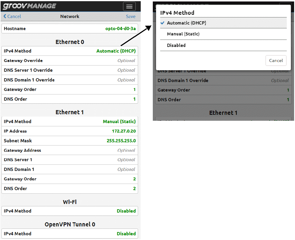

On all network interfaces, groov products use standard network services like DHCP and DNS.
  • DHCP (Dynamic Host Configuration Protocol) dynamically and automatically assigns IP addresses to your groov RIO or EPIC.
  • DNS (Domain Naming System) services make it easier to access your groov product on the network by letting you use a hostname rather than an IP address. (You use DNS every day to reach websites like google.com by typing in the name “google.com” rather than the IP address of Google's servers.)
If necessary, you can configure your groov device to use optional static IP configurations, but the default is DHCP and DNS. For name resolving and outbound, device-originating access to other networks, you can use groov Manage to choose standard DNS and Gateway addresses and automatic or manual configuration.

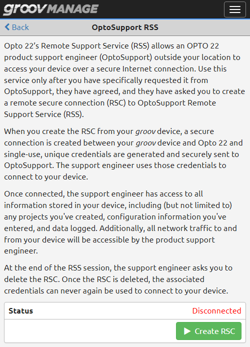

Using a VPN for product support
You can also create a secure VPN tunnel to Opto 22 Product Support.
Suppose you are having concerns about your groov product and contact Product Support for assistance. If you think it would be helpful, you can use groov Manage to open a VPN tunnel so that the Product Support Engineer can temporarily access your device and help resolve the issue. (See image.)
You will need a properly configured gateway to the internet in order to connect to Opto 22's Product Support VPN server.

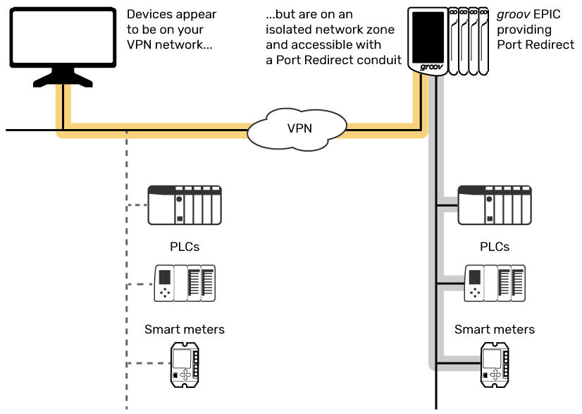

Port redirect feature: creating conduits between zones
In some cases you may want to reach devices that are in a network zone isolated by your groov product. For example, perhaps you have another PLC or networked device on your trusted network (OT network) that you want to reach from another trusted network (like a VPN) or other configured network interface (see illustration below).
Maybe you need to make changes to that PLC or device from that system’s own proprietary software (for example, RSLinx software from Rockwell Automation® connecting to an Allen-Bradley® PLC). Normally, such connections are not secure.
By design, a groov device’s default configuration does not route traffic between network interfaces. However, an advanced feature available in groov EPIC firmware version 3.2 or higher and groov RIO firmware version 3.4 or higher lets you designate a port redirect to permit network traffic coming in on one interface’s network port to pass through to an IP address or host’s port on another interface, creating a conduit between zones.
CAUTION: Use extreme caution here to ensure that an unsecure open port does not exist on an untrusted network interface!
As discussed in Firewalls (below), best practice is to block all unsecure network ports (like Modbus®/TCP port 502) on untrusted network interfaces. However, a VPN tunnel created on an untrusted network interface allows only authenticated, encrypted data communications over that interface, so only authorized users can gain access.
In this scenario, you configure a port redirect—a conduit—from the VPN tunnel interface from the untrusted network zone, where the VPN tunnel is established, to the trusted network zone, where the unsecure PLC is. Network packets are then redirected through this conduit. Ideally, you enable the conduit only on demand and for a limited time period. You can do so in either of two ways:
  • Directly in groov Manage, which uses secure HTTPS (port 443)
  • Programmatically in other applications on your groov product—Node-RED, Ignition Edge, PAC Control, or other software—using the REST API to enable and disable the port redirect
This scenario delivers a temporary and fully secure method for accessing devices on an isolated network zone from anywhere another client VPN connection is established. These devices appear to be on your VPN network, but in reality they are on a separate network zone attached to your groov RIO or EPIC.

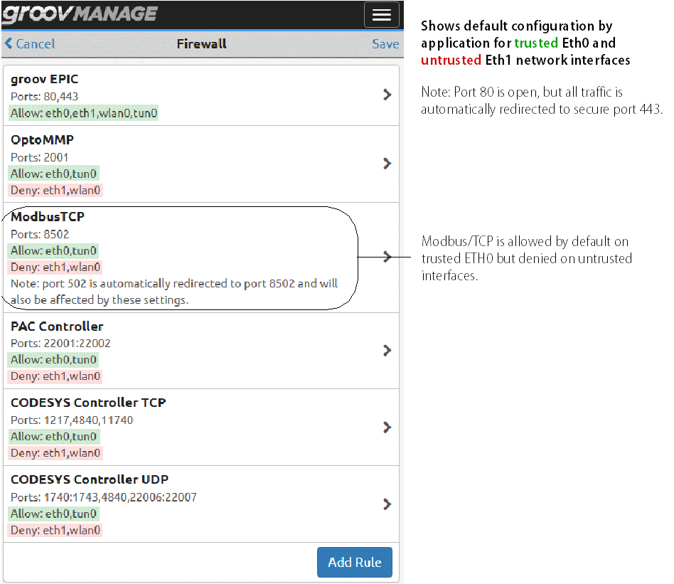

Default device firewall configuration
By default, the device firewall on groov products blocks unsolicited inbound traffic on all network interfaces, allowing only responses to device-originated connections to come through. For example, let’s look at the default firewall configuration for the groov EPIC’s Ethernet interfaces
The groov EPIC processor’s internal firewall default configuration assumes that you are using the two wired network interfaces as designed to isolate trusted and untrusted network zones:
On the Ethernet trusted network interface (ETH0), groov EPIC allows network communications through necessary but unsecure industrial protocol ports that are configured open. These ports allow communication with software and protocols in the groov EPIC processor, for example:
  • PAC Control™ and CODESYS® (development tools)
  • OptoMMP (protocol used by the EPIC’s I/O)
  • Modbus/TCP (for communication with PLCs and other devices)
On the Ethernet untrusted network interface (ETH1), groov EPIC allows traffic only on secure port 443 and permits only authenticated access over secure, encrypted connections. This network interface provides authenticated, encrypted access to groov Manage, groov View, Node-RED, and RESTful APIs.
All other inbound connection ports on the ETH1 Ethernet network interface are blocked by default.

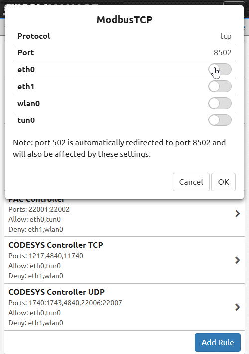

For both groov EPIC and groov RIO, groov Manage shows the configuration for each network interface by application, so you can clearly see which applications are allowed access and which are denied:
Remember that the default configuration assumes that ETH0 is on a trusted network. Make sure that network actually is trusted.
You can configure the groov EPIC’s or groov RIO's firewall for each network interface to suit your application. For example, you can change the default configuration to close ports for any services that won’t be used. In the image at right (or below), if you are not using Modbus/TCP, you should close port 8502 so it will not allow any traffic, even on the trusted network interface:
Optional WiFi and VPN interfaces have the same default firewall configuration, and for both groov RIO and groov EPIC, you can change them similarly in groov Manage.

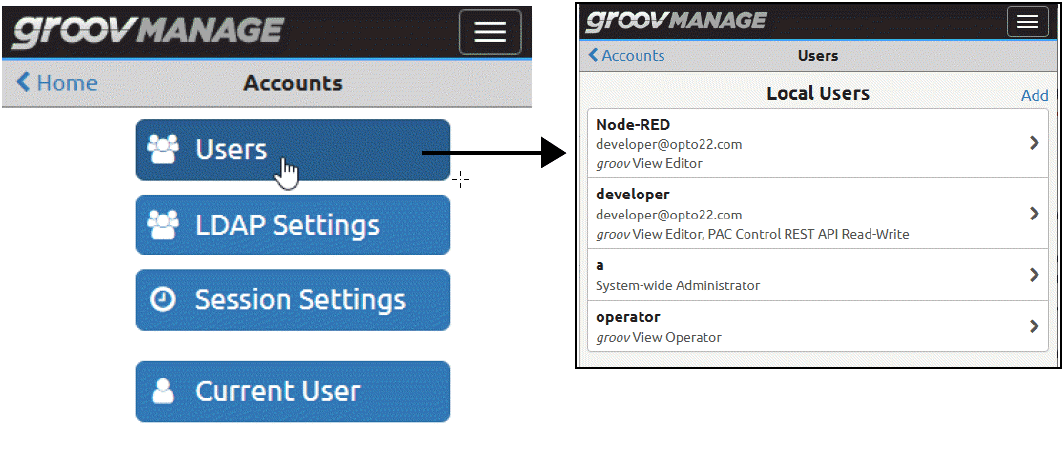

Controlling who can access your data and exactly what each user can do with it is a vital part of cybersecurity.
When you first start groov RIO or groov EPIC, you must create a local administrator account with your own username and password before you can do anything else. groov products do not have a default username or password that someone might be able to guess.
For security, the administrator account credentials you create are not recoverable.
groov products provide user account management through groov Manage. You can create administrator, developer, operator, REST API, and other accounts, and then assign permissions to authorized people or software services. Authentication (over an encrypted connection) is by either username/password or API token.
All users can create long, complex passwords consisting of numbers, capitalization, punctuation, spaces, phrases and words in any language, and even emoticons.
As an administrator, you can also set user session timeouts globally, adjusting the timeout for individual users as needed. You can set user sessions to never expire or to run from 30 minutes to two weeks.

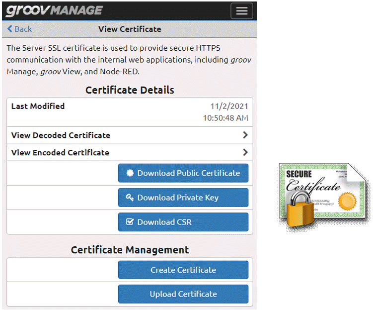

Security certificate management
Security certificates are a way that clients can verify servers, so that when one tries to connect, it can be assured it's communicating with the correct server and not an impostor. groov products provide built-in certificate management in groov Manage.
groov RIO and groov EPIC support X.509 PKI standard certified client connections to secure servers (Client SSL) and from clients to the groov device’s secure server (Server SSL) using TLS/SSL certificates, which can be device generated, self-signed, or registered publicly through a Certificate Authority (CA). For more information on certificates, see your groov product user’s guide, our videos on security certificates, and examples on developer.opto22.com.

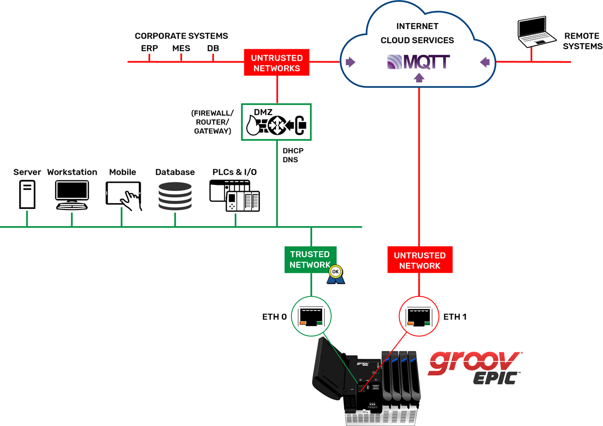

The following diagram illustrates how MQTT works with groov EPIC.

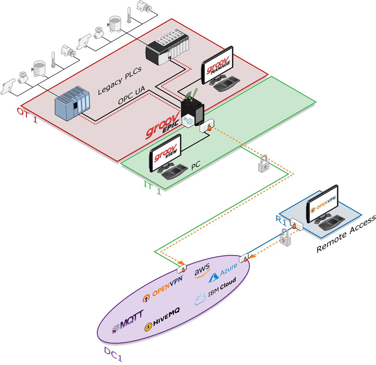

Realtime I/O sensing and control

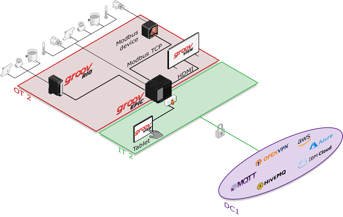

We’ll start with a real-time I/O sensing and control application, shown in the image below, potentially operating in a hazardous area. Traditional field assets like sensors and switches are wired directly to the groov EPIC’s I/O modules or to groov RIO modules acting as remote I/O. These groov devices can also communicate with Modbus devices over Modbus/TCP. As shown, groov EPIC also provides a local operator interface using groov View and a connected HDMI monitor.
Using its device firewall and independent network interfaces, the groov EPIC delineates two security zones: a trusted network for the local control system (OT2) and an untrusted network for external clients (IT2).
The groov EPIC serves up data through encrypted connections to PCs and mobile devices in IT2 or, through it, to applications on premises and in the cloud.

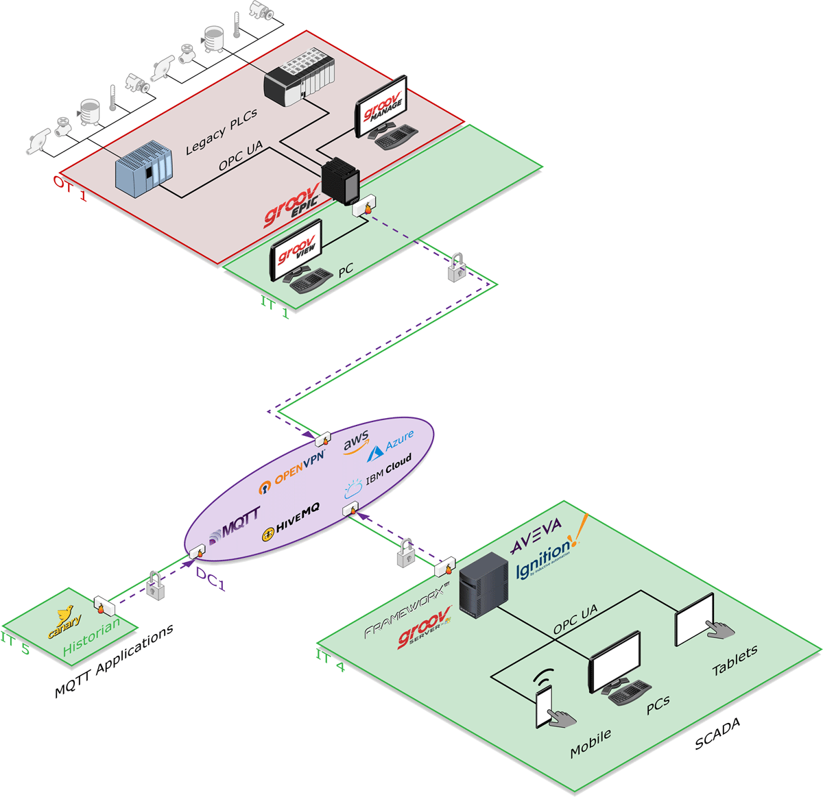

What if you have an existing system, but you need to get the data that’s locked in legacy PLCs? Here you’re using a groov device for its port redirect capabilities. All groov EPIC processors and groov RIO model GRV-R7-MM2001-10 run Ignition from Inductive Automation. These groov products can connect to legacy PLCs via Ignition’s built-in native drivers and communicate PLC data via OPC UA.
All the data you need from legacy systems can be used in the same ways, in software and services on your premises or in the cloud (DC1), including VPN tunnels (orange dotted).
And here’s an added bonus: securely accessing your PLCs. For example, suppose you need to update a PLC’s program from your PC at another site (R1). Using a VPN and groov RIO’s or EPIC’s port redirect feature, you can establish a conduit (red dotted) to securely access your PLC and make the change.
The diagram below shows a groov EPIC processor as an example. With groov EPIC (and groov RIO with firmware 4.0.1 or higher), you can also separate OT and IT networks into two zones for security. With groov EPIC’s built-in groov View HMI, you can use legacy PLC data in your operator interface, locally and on mobile.
MQTT/Sparkplug B for multi-vendor integration
Using MQTT/Sparkplug B adds efficiency, scalability, and interoperability to data communications and expands the applications you can integrate with groov RIO and groov EPIC. With MQTT, data from devices and systems wired to your groov product, as well as legacy PLC data, are communicated via an outgoing connection—which, once established, allows data to flow in both directions while requiring no open firewall ports (see Data communication options for better security, above).
Here we see how data moves through MQTT/Sparkplug B connections (purple dash). MQTT applications like Canary’s Historian can easily exchange data with field devices and systems, as can SCADA systems.

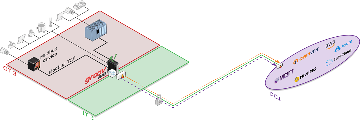

Data acquisition from field devices
Suppose you don’t need real-time control capability, but you still need data from field devices. Here’s where groov RIO shines. For example:
  • The groov RIO EMU energy monitoring unit wires directly to 3-phase power loads and sends 64 channels of power and energy data (some measured, some calculated) wherever it is needed for tracking and analysis.
  • The groov RIO MM2 universal I/O module (shown in the diagram below) talks to Modbus devices, connects directly to field devices, and runs Ignition Edge with its PLC drivers, acquiring data from everything at the site.
Like EPIC, groov RIO can share acquired data with other devices and software on premises and in the cloud using MQTT/Sparkplug B, Node-RED, and a VPN.
groov RIO’s device firewall and encryption help secure this site. By default, groov RIO's two physical Ethernet network interfaces are switched. But with firmware 4.1.0 or higher you can configure them to be independent, and in addition you can add WiFi and a VPN to separate networks into up to four zones.

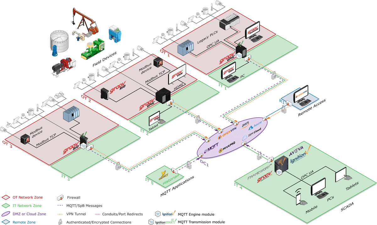

Complete groov EPIC System architecture
Putting it all together, you can see a flexible, scalable system architecture that can help you build a secure system to meet your individual project requirements. Take a look at the diagram below, and then continue with groov Products Best Practices for Cybersecurity, below.

  • Be sure to place unsecure devices (like legacy PLCs or devices) only in the trusted network zone.
  • In any untrusted network zones, permit only secure, encrypted, and authenticated connections.
  • For groov EPIC, use the ETH0 Ethernet network interface for your trusted network and ETH1 for any untrusted network. For groov RIO, if you configure its two Ethernet network interfaces to be independent (requires firmware 4.1.0 or higher), use Eth0 for your trusted network and Eth1 for an untrusted. Configure exceptions in the system’s firewall only if required for your application.
  • Use WiFi or VPN network interfaces on both groov RIO and groov EPIC for zoning.
  • Configure the system’s firewall in groov Manage to close all unneeded network ports on all network interfaces.

  • Use a VPN if you need remote, encrypted access to your groov product over an untrusted network.

If someone attempts to connect an Ethernet cable to the groov EPIC processor to try to access the system from their computer, the ports will be closed and network access will be denied. Only an authorized user with administrator privileges can access groov Manage through groov EPIC’s built-in display to reopen needed ports and gain network access.
