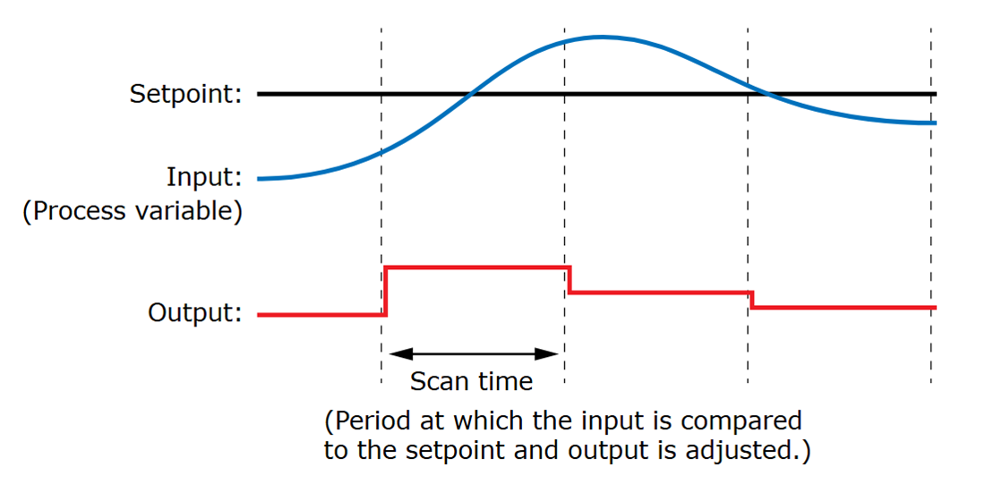

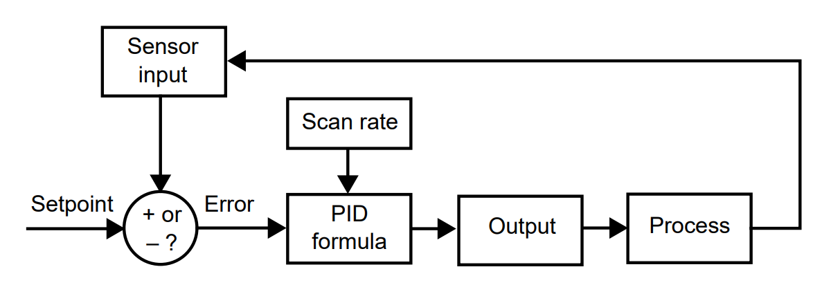

A PID control loop is a mathematical formula that monitors a process variable (typically a sensor input), compares it to a setpoint, and calculates an output to keep the variable as close as possible to the setpoint.
The sensor input is scanned at a set rate (for example, once per second). At each scan the loop controller compares the input to the setpoint and notes the error (the difference between them). Then it plugs the error into a mathematical formula with the proportional, integral, and derivative values, and calculates an output to put the process back on track. The loop repeats at the next scan.
It looks like this:

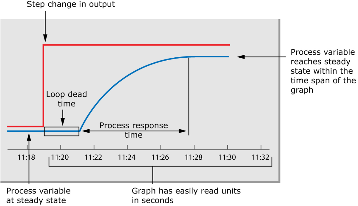

Loop dead time
The amount of time it takes the process to start reacting to a change in the input is called the loop dead time. This time delay is a combination of factors, starting with the process itself, the location of the sensors, and any filtering (hardware or software) that may be installed.
For example, moving the temperature sensor physically closer to the output actuator may reduce the loop dead time, but you must take care that the sensor still measures the process accurately. You have to find a balance between the loop dead time and accuracy.
Scan rate and scan time
  • How often the PID calculation is performed—how many times per second—is called the scan rate.
  • The amount of time between scans is called the scan time (or scan interval). For example, a scan rate of 4 times per second equals a scan time of 0.25 seconds.
Scan rate is a very important aspect of configuring the PID loop. If the calculation is done too seldom, you won’t be able to control the process; if too often, the loop might be hard to tune.  When setting the scan rate, at all times keep in mind the speed limits, if any, of your input and output devices, both sensors and actuators. There’s no point in scanning faster than they can update.
Since the PID calculation is only performed at the scan time (scan interval), be aware that the output will remain static until the next scan. This is why it’s important to correctly set it, so the output will react to the input in a timely manner.
Generally, set the PID scan rate so that the loop scans between four and 10 times during the loop dead time interval. The shorter the loop dead time, the shorter your scan time should be.
For example, if the loop dead time is 3 seconds, a possible PID scan time could be somewhere between 0.75 seconds and 0.3 seconds:
  • 3 seconds/4 = 0.75 s.
  • 3 seconds/10 = 0.3 s.
The scan rate (scan time) determines how often the PID calculation is performed.

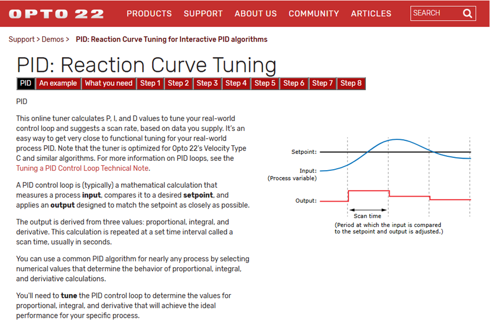

Using the free online tuner
Whether you use Opto 22 controllers or a different PID loop controller, you can use our free online graphical PID tuner. It's a huge help if you use PID control loops only now and then, or if you are looking for a less-math-more-visual way to tune your PID loop. It uses the reaction curve open-loop method, specifically the Ziegler-Nichols Reaction Curve (Ziegler-Nichols Open-Loop) tuning method and is optimized for Opto 22’s Velocity Type C and similar algorithms.
NOTE: This method works well to tune most temperature and some pressure processes. It isn't as useful on slower flow or very dynamic processes, for example a process where the dead loop and response curve are similar in length. Likewise it's less effective if you have a very long loop dead time, for example HVAC in a large conference room or hall.
The online tuner calculates the values for PID control loop elements (P, I, D, and scan time) based on data you enter. It’s an easy way to get very close to functional tuning for your real-world process PID, giving you a good baseline for your PID parameters.

Start by opening the free online PID tuner.
Free online PID tuner

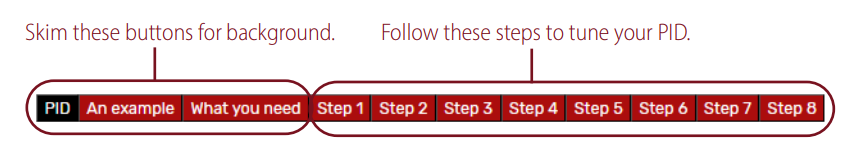

In the tuner
The buttons at the top of the tuner explain PID loops and walk you through the process (the first three are explained in more detail in this article):
Tuning procedure
If you already have some rough tuning values for your PID loop, use them. If not, don’t worry; we start with the loop in manual. In either case the procedure is the same: we step the process from one steady state to another steady state, and capture the curve of the process in a graph that can be printed out on paper.
Use Step 1 in the tuner as a guide for the response curve graph that you need. If the curve of the process overruns the time scale of your graph the first time, reset the process, extend the time scale, and step through the process again. Or if the process is very responsive and the resulting curve is too compact to measure, reset the process and speed up the graph.
You may need to take a few trial runs at generating a nice clean curve on paper, but as you gain experience in using this tuning method, you’ll be faster at getting it right the first time.
Follow the steps

Measure on your printout how long it took the process to change from its lower steady state to the 63.2% point on the curve. In the tuner, enter the distance you measured.
This distance will be converted to time in the next step so that we can determine the loop time constant. This is the amount of time that it took the input to move from its lower steady state to the 63.2% point of the input curve. This time tells us how dynamic the process is and is an important part of the Integral value calculation.
Step 6: Enter the time scale values.
On your graph, measure the distance between two known points of time. In the tuner, enter the Time scale in time units (the scale you used, in seconds) and the Time scale on paper (the distance you measured, in millimeters).
Step 7: Determine the loop dead time.
On your graph, measure the distance between the step change in the output and the beginning of change in the input. In the tuner, enter this process loop Dead time, which is the amount of time it takes the process to begin to react to a change.
Dead time is an important part of understanding how frequently you should set the PID controller to perform its loop calculation. The online tuner calculates a PID scan rate that sets the loop to scan four times during the loop dead time interval you enter.

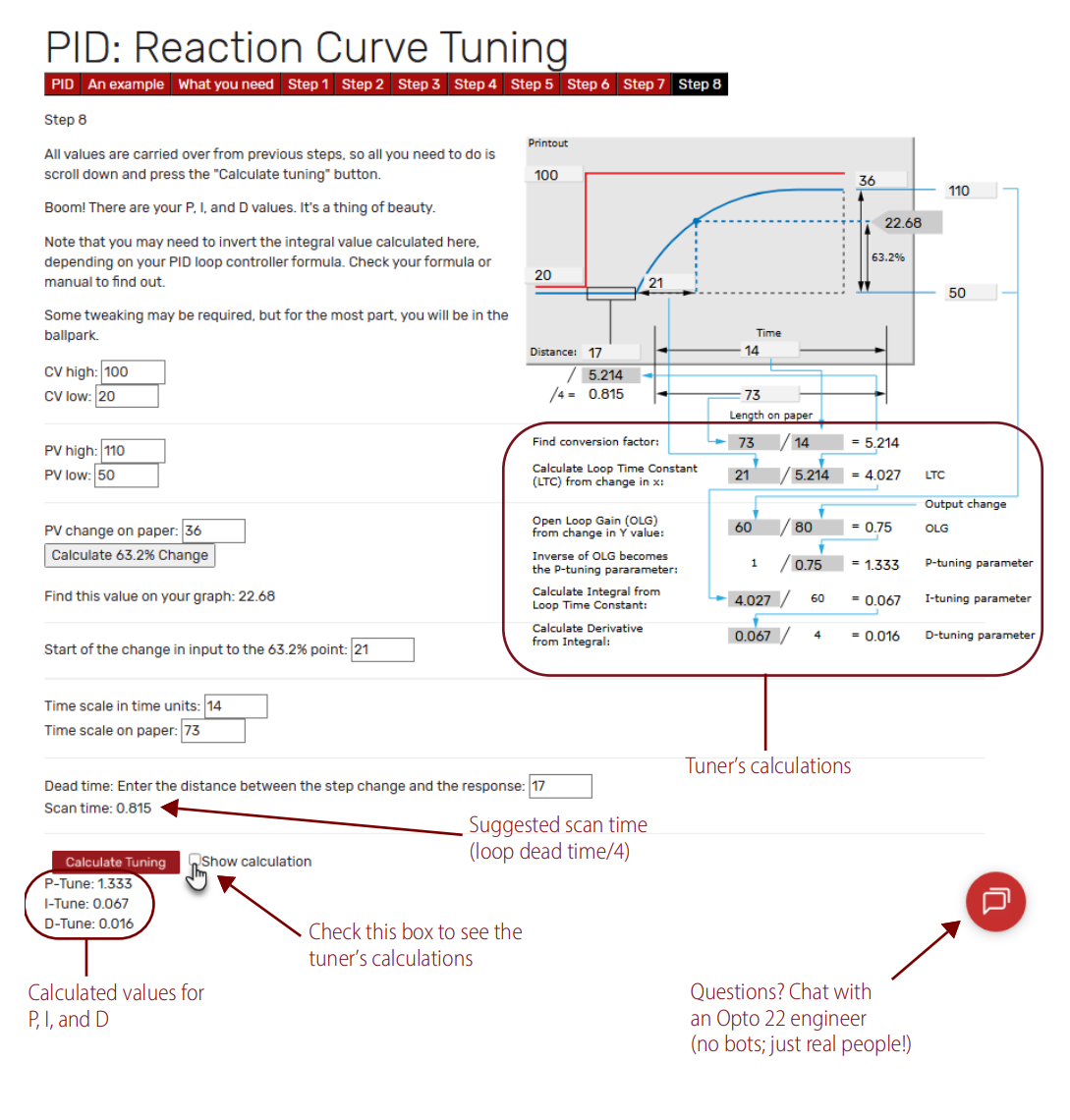

Step 8: Get the final calculations.
The tuner now has all the data it needs to calculate the P, I and D values for you and to suggest a scan time. Press the Calculate tuning button and write down the results. This provides a starting point for tuning your PID loop.
If you want to understand the process that the tuner uses to compute those numbers, check the Show calculation box.
Here's an example of the result:
Example: results of tuning a PID loop with the free online tuner
For each PID loop, we suggest using the free online tuner to get a rough baseline for P, I, D, and scan time.
