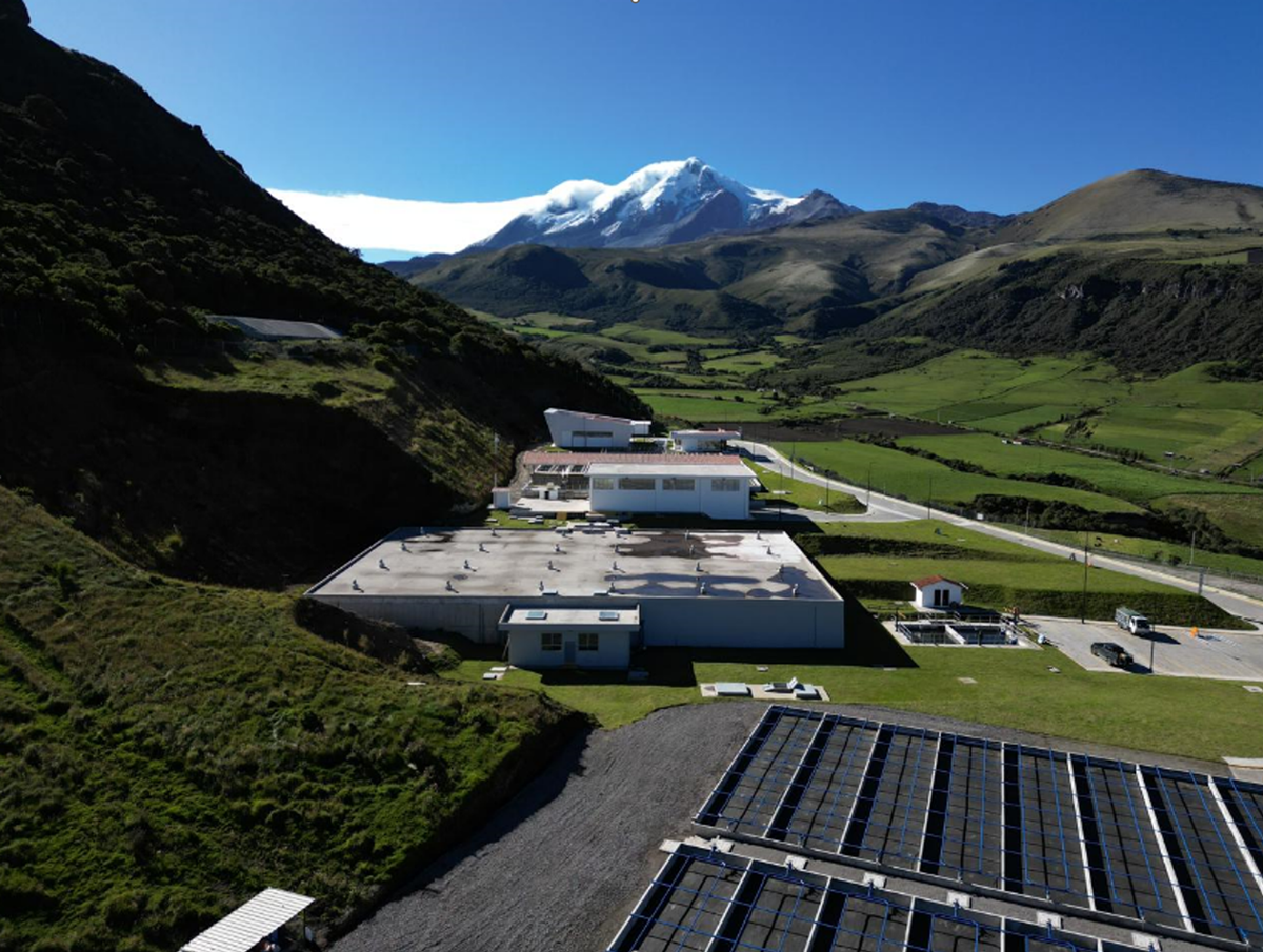

The Pesillo water treatment plant in Ecuador, set against the Andes mountains, has solar arrays to support sustainable operations.

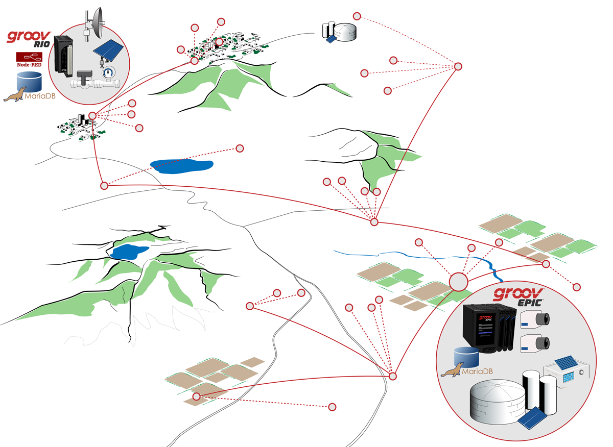

A geographic view of the SCADA system linking water treatment and distribution sites across Ecuador.

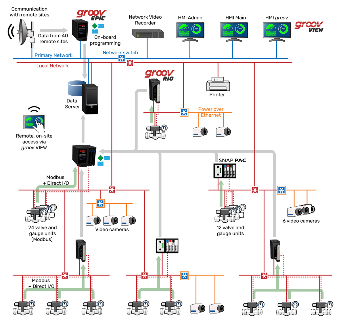

Next Control designed a two-layer system:
  • At the treatment plant, two groov EPIC controllers handled centralized control with redundancy.
  • Across the distribution network, 36 groov RIO modules measured flows, controlled valves, and logged data locally.
“The EPICs gave us reliable control at the core,” Estrada says. “And with RIOs in the field, each site could keep running even if communications went down.”
Network architecture of the treatment plant using groov EPIC, groov RIO, and groov View for control and monitoring

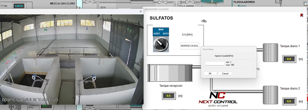

A PAC Display interface with an integrated live camera feed for alum sulfate dosing at the Pesillo water treatment plant

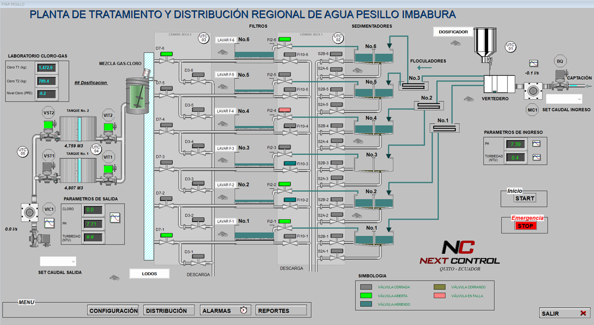

Inside the plant, groov EPIC controllers automated core processes: dosing chemicals, removing sediment, and moving treated water into the pipelines. Operators used PAC Display on a local server to monitor everything in real time.
Next Control also extended operator visibility. They connected live cameras to the HMI, and when an operator clicked a section of the plant in PAC Display, the system launched a .NET application that opened the video feed. The same mechanism generated reports, so operators could handle daily tasks without leaving their familiar interface.

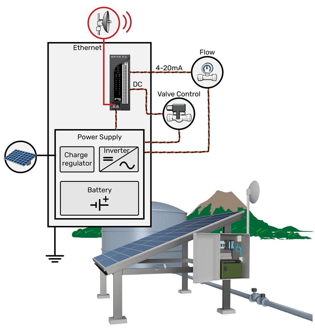

Across the mountains, each of the 36 remote sites needed to keep running even when communications failed. Next Control configured every groov RIO with its own Node-RED logic—simple, flow-based programming that runs directly on the device—and a local MariaDB database, an open-source system for storing data. Local control and data storage allowed each site to operate on its own for days or even weeks, then automatically sync its records back to the plant once the link returned.
To connect the network, the team installed 5.8 GHz directional antennas across valleys and ridges. This private system gave municipalities secure, reliable communications without relying on public internet services.

Camera feeds gave extra confidence because operators could check valves and tanks directly on screen rather than trusting numbers alone.

Real-time PAC Display overview of the Pesillo regional water treatment and distribution plant
groov RIOs automate each solar-powered, remote flow and valve control system.
