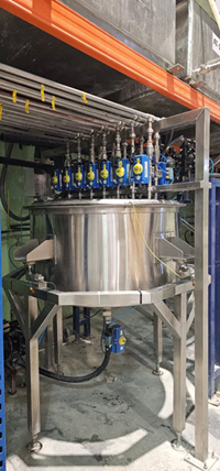

The existing PLC-controlled dosing and batching system lacked precision, often resulting in large discrepancies between the requested and delivered amounts of additives. A typical request for 30 pounds of additive could result in anywhere from 20 to 40 pounds, which led to out-of-spec batches and waste.
At Pinturas Tropical, operators had to navigate this inadequate system. To avoid costly errors, they would request just a fraction of the required amount of each additive and add the remainder manually, increasing labor costs and time for the production process, not to mention introducing the possibility of human error.

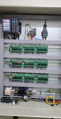

The new system was designed to address precision issues head-on, using Time Proportional Output (TPO) to control dosing valves. TPO is a form of Pulse Width Modulation (PWM) that works by controlling the duration that a dosing valve is open and using fixed timing cycles to precisely control flow rate from the dosing pump.
TPO was enabled using groov EPIC’s GRV-ODCSRC-24 discrete DC output module and Opto 22's PAC Control flowchart-based programming software.
Modbus for measurement:
Lugo made use of the free Modbus/TCP integration kit provided with PAC Control to communicate in real time to custom-built weight scales. Each scale had a Modbus/TCP enabled transmitter outfitted with 4 load cells. Using high-speed Ethernet communication provided real-time feedback on the amount of additives delivered.
groov View for visualizations:
Each groov EPIC comes with a web-based visualization software called groov View, which allows any user on the network with the appropriate credentials to see current and historical status of the system.
Lugo also utilized groov View as a way for operators to enter batch parameters and signal the system to start or stop batching operations.
Node-RED for record keeping:
Since each groov EPIC also comes preloaded with Node-RED, a flowchart-based programming environment for IIoT applications, RMS made use of the open-source platform to write batch data to a PostgreSQL® database. Lugo recalls, “At the end of each batch, a PAC Control variable is toggled true, which signals Node-RED to read a string table that contains all the batch information: batch number, requested amounts, delivered amounts, target time, date/time, etc. From there, we use a Node-RED PostgreSQL node to move those values into a database."
