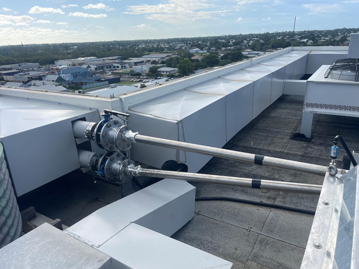

Strict building regulations prohibited drilling into walls, floors, or ceilings, meaning no new conduit runs between floors. The solution had to work with the building as it was, using only existing cable pathways.

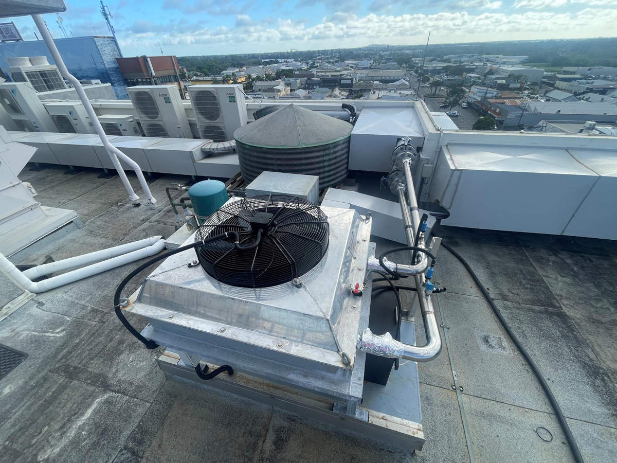

To restore cooling, the bank installed a radiator on the building’s roof and repurposed existing copper piping to circulate coolant. A three-phase fan pulled air across the radiator, dissipating heat before the coolant returned to the generator, creating a closed-loop cooling system.

The rooftop radiator of the bank's headquarters

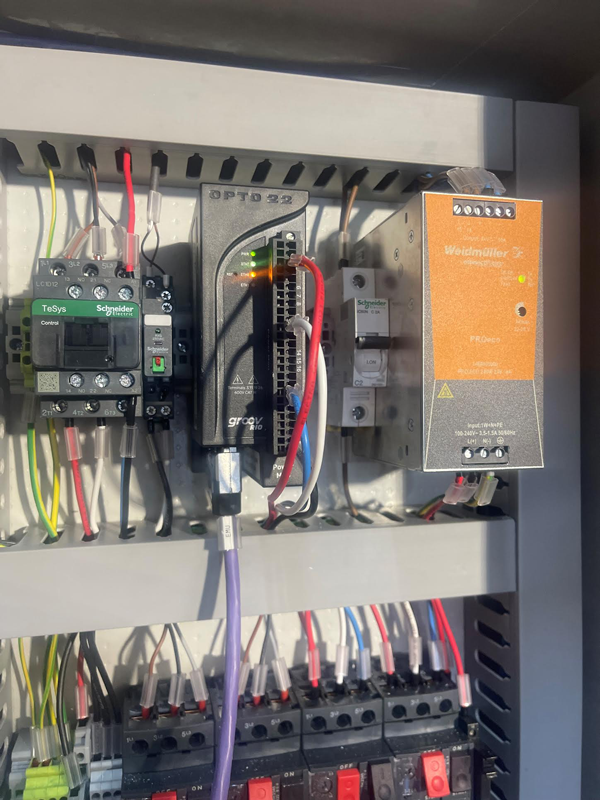

That’s where the Opto 22 groov EPIC® came in. More than just a PLC, the groov EPIC (Edge Programmable Industrial Controller) combines real-time control with built-in networking, data processing, and secure access. It also includes groov View® for built-in, web-based, and local visualization that allows operators to monitor and adjust the system from any connected device.
To further enhance monitoring, a groov RIO® Energy Monitoring Unit (EMU) was installed to track voltage, current, and power conditions, ensuring stable operation and helping detect fluctuations that could impact generator performance.
With direct Ethernet integration to groov EPIC, the groov RIO EMU provided real-time energy data with simple software configuration and no complex wiring.
groov EPIC handles central control from the generator room.

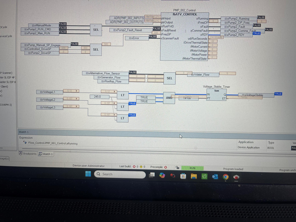

For the bank’s application, Binford Tech and ProSwitched used CODESYS®, a PLC programming environment and runtime that allows for flexible IEC 61131-3-compliant programming. Each groov EPIC includes a free CODESYS runtime license, enabling advanced communications and control logic without any added cost. The team used several CODESYS capabilities:
  • IEC61131-3 program logic—monitoring and controlling equipment in real time
  • Modbus®/TCP communication to Variable Speed Drives (VSDs)—controlling cooling system pumps and fan speeds
  • Ethernet/IP communication to IO-Link master devices—integrating with smart sensors for real-time monitoring
  • OPC UA® server for communication to groov View—allowing visualization for operators to monitor system performance and adjust setpoints

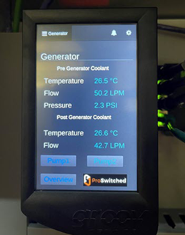

Every groov EPIC includes a web-based visualization platform called groov View, which runs both on the groov EPIC’s LCD display and on any network-connected devices. The bank’s application used groov View for the following features:
  • Monitoring—to display real-time data from temperature, pressure, and flow sensors
  • Adjustments—to let operators modify setpoints and control parameters remotely
  • Alerts—to send email notifications when generator cooling thresholds are exceeded
  • Troubleshooting—to provide historical trends and diagnostic data to identify potential issues
groov View gave us exactly what we needed—local monitoring, on-site control, and automated alerts—all without adding extra HMI or display hardware,” says Anderson.

Rooftop views: new radiator pipes connected to existing copper pipes
