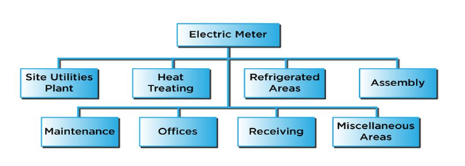

How to get started monitoring energy
Begin with the main electrical panel at your facility. Then move down to subpanels and then to individual machines.
Energy monitoring hierarchy
When you measure energy usage at each point and then take a close look at your electric bill, you will see ways to reduce costs. Typically utility bills include two charges for industrial customers: one for total energy consumption and one for peak demand, which is the maximum used at any point during a specified time interval (for example, within 15 minutes). The peak demand charge can be even more than the consumption charge. But you can often find simple ways to reduce peak demand: staging compressors, cycling air handling units, balancing loads, repairing or replacing faulty equipment.
