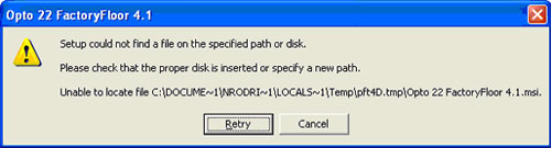

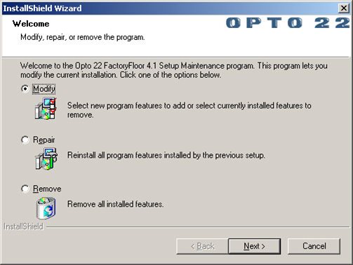

A series of error messages are displayed if there is an attempt to install FactoryFloor R4.1a on a computer that already has FactoryFloor R4.1a installed. This problem occurs if the Modify option is selected from the InstallShield Wizard.
The message below appears:
Workaround:
If re-installing FactoryFloor is necessary, uninstall FactoryFloor first before attempting to install it again.
