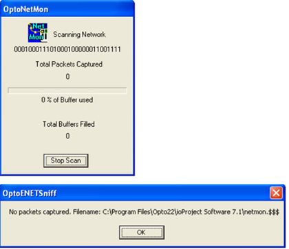

Symptoms:
When a capture is started in OptoENETSniff, no packets are captured.
Workaround:
Uninstall and reinstall ioProject.
Resolution:
Opto 22 is aware of this issue. It is recommended OptoENETSniff be uninstalled and the Ethereal package be used instead.
