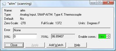

PAC Control debug mode always displays the zero-scale and full-scale limit values in degrees C for temperature I/O points, even if the I/O Unit is configured for degrees F. As shown below, the IVAL and XVAL values are correct, and the I/O Unit is labeled as degrees F, but the limit values are incorrect (the ones shown are the limit values for degrees C).
