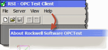

How to tell if your OPC Test Client is affected
The OPC Test Client that contains the vulnerability was released with PAC Project versions R9.4007 and lower. We recommend you delete this older client, which looks like this (see steps to delete in the Resolution section, below):
