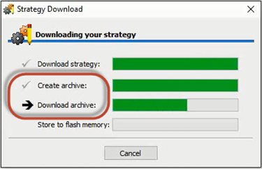

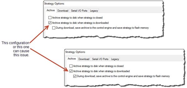

If you've configured PAC Control to automatically create an archive when a strategy is downloaded, PAC Control may crash during the strategy download if you press the Cancel key during the Create Archive or Download Archive step.
For this issue to occur, your configuration would look something like this (File > Strategy Options > Archive tab):
