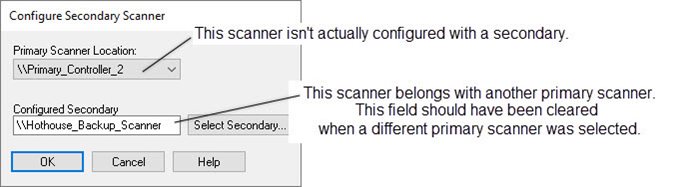

Symptoms:
In the Configure Secondary Scanner dialog box (Configure > Secondary Scanner Location), sometime a value is displayed in the secondary scanner field when, in fact, the selected primary scanner isn't configured for a secondary scanner.
This issue happens only when you first select a primary scanner that does  have a secondary scanner, and then select a primary scanner that doesn't  have a secondary scanner.
When this happens, the Configured Secondary field should be cleared (but it isn't).
Note: This issue doesn't affect how the project functions in Runtime; it relates only to what should be displayed in PAC Display Configurator.
