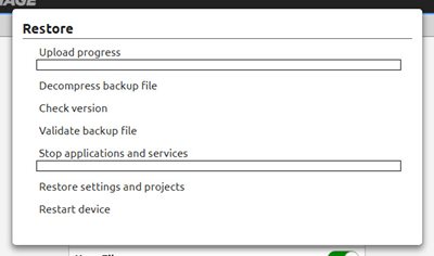

If you drag-and-drop something other than a file into a file upload area, groov Manage displays the progress window, but there appears to be no progress being made. The following screens have file upload areas:
  • Node-RED Project Management
  • Update
  • Restore
The following image shows no progress on a Restore process when something other than a file was dropped into the file upload area of the Restore screen:
