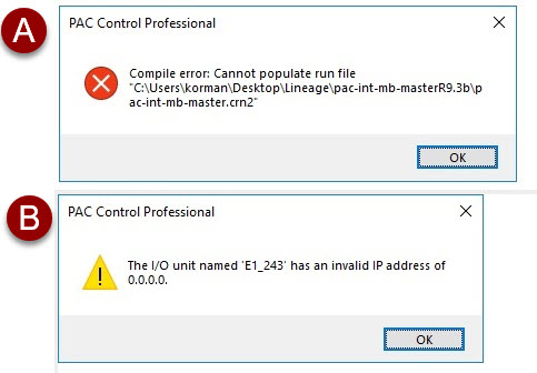

PAC Control displays "Compile Error" and "Invalid IP address" when a strategy includes an E1, E2, or G4EB2 brain board

If your PAC Control R10.0a or R10.0b strategy contains an E1, E2, or G4EB2 brain board, PAC Control displays an error message when you try to either compile or download the strategy.
Error message A appears when you try to compile the strategy.
Error message B appears when you try to download the strategy.
