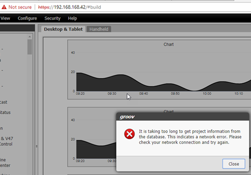

In groov View's Build mode, Accounts dialog box won’t open; gives “network” error

Symptoms:
In groov View's Build mode, the Accounts dialog box won’t open (Configure > Accounts). An error message says, "It is taking too long to get project information from the database. This indicates a network error. Please check your network connection and try again," as shown below. This error may occur with a large project or a slow connection.
