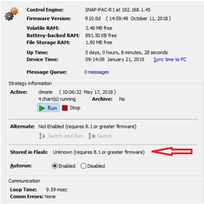

When using PAC Control 9.6 (or lower versions) with a controller that has firmware 10.0 (or higher), PAC Control debug mode uses older versions of debugger commands to read/write data. This may result in errors or incorrect data.
Note: This only affects PAC Control debug mode; it does not affect the commands used in your PAC Control strategy.
Examples of symptoms include: An I/O unit may report incorrect values for IVALs and/or XVALs.
If you inspect the controller using PAC Control or PAC Terminal, you may see incorrect warnings:
Note: Not all symptoms are known
Workaround:
Use PAC Control 10.0 or higher when using a controller with firmware 10.0 or higher. If you cannot upgrade to PAC Control 10.0 or higher, then use controller firmware R9.5h, which is available at ​​ftp://ftp.opto22.com
