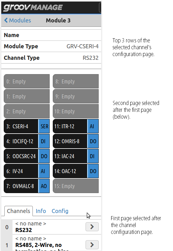

When you leave your finger on the touch-sensitive pad of a module and then you select a channel on that module, you may observe that the top 3 rows of the channel information page stay at the top of the display. Below that, any pages you select (tap) afterwards are stacked. The following is an example of this behavior: 88896.png
